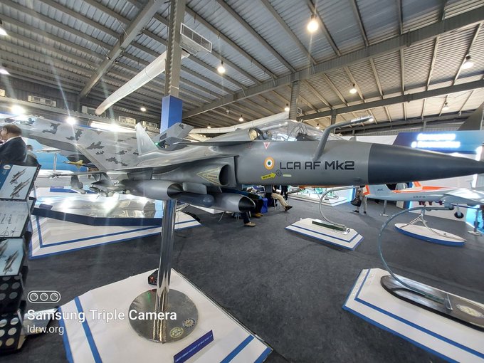

Timeline now 2029 for first induction of Tejas Mk2 to IAF. Now Tejas Mk2 being slot to be replacement basically to all Fighter in IAF inventory asside Su-30MKI and Rafale. Means replacement for Jaguar, Mig 29 and Mirage 2000.
