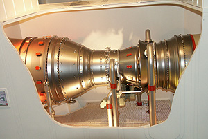

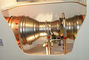

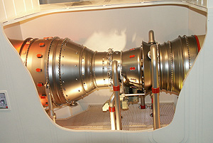

This is the solution for HAL Tejas by GE, new engine modified by GE for the production variants of HAL Tejas, modified for Indian conditions (perhaps you will see why India went for a western engine):
F404-GE-IN20 turbofan engine
Applications: Indian Tejas Light Combat Aircraft
Performance Specifications (sea level/standard day)
  • Thrust Class: 19000 lb, 84 kN
  • Length: 159 in, 404 cm
  • Airflow: 153 lb/sec,70 kg/sec
  • Weight: 2365 lb, 1072 kg
  • Inlet Dimension: 28 in, 71 cm
  • Pressure ratio: 28:1, 28:1
FE404-GE-IN20 engine is an enhanced production version the F404-GE-F2J3, which powered the LCA demonstrator.
The highest thrust variant of the F404 family, the -IN20 incorporates GE's latest hot section materials and technologies as well as a Full Authority digital Electronic Control(FADEC) with proven single engine features for maximum sa fety and relaibility.
It provides the Tejas LCA with reliable power outstanding operational and handling characteristics. Its simple, modular sesign is reliable and easy to maintain.
The IN 20 is a derivative of highly successful F404 turbofan, with over 11 million flight hours experience on the Boeing F/A-18 and other combat aircraft.
Source: GE.
dum dum dum.
Another joint venture to run.
Will they go Russian?
or will french have some fun?
The Hindu
Kaveri engine for Tejas: more talks on French, Russian offers
Monday, Oct 15, 2007
"Another meeting among key officials from the GTRE, the Indian Air Force and Hindustan Aeronautics Limited (HAL), which is expected to be held next week, will hopefully enable the TAC to make up its mind on who — between the French aerospace company Snecma and Russia’s NPO Saturn — will join the GTRE in developing the engine. One of India’s most crucial aeronautical programmes, Kaveri is expected to power the indigenously developed Light Combat Aircraft (LCA) Tejas. Around 300 engines are scheduled to be manufactured."
The DRDO’s preference for the Snecma offer is because it is “offering technology that is slightly superior to what the Russians are providing,” said the source
