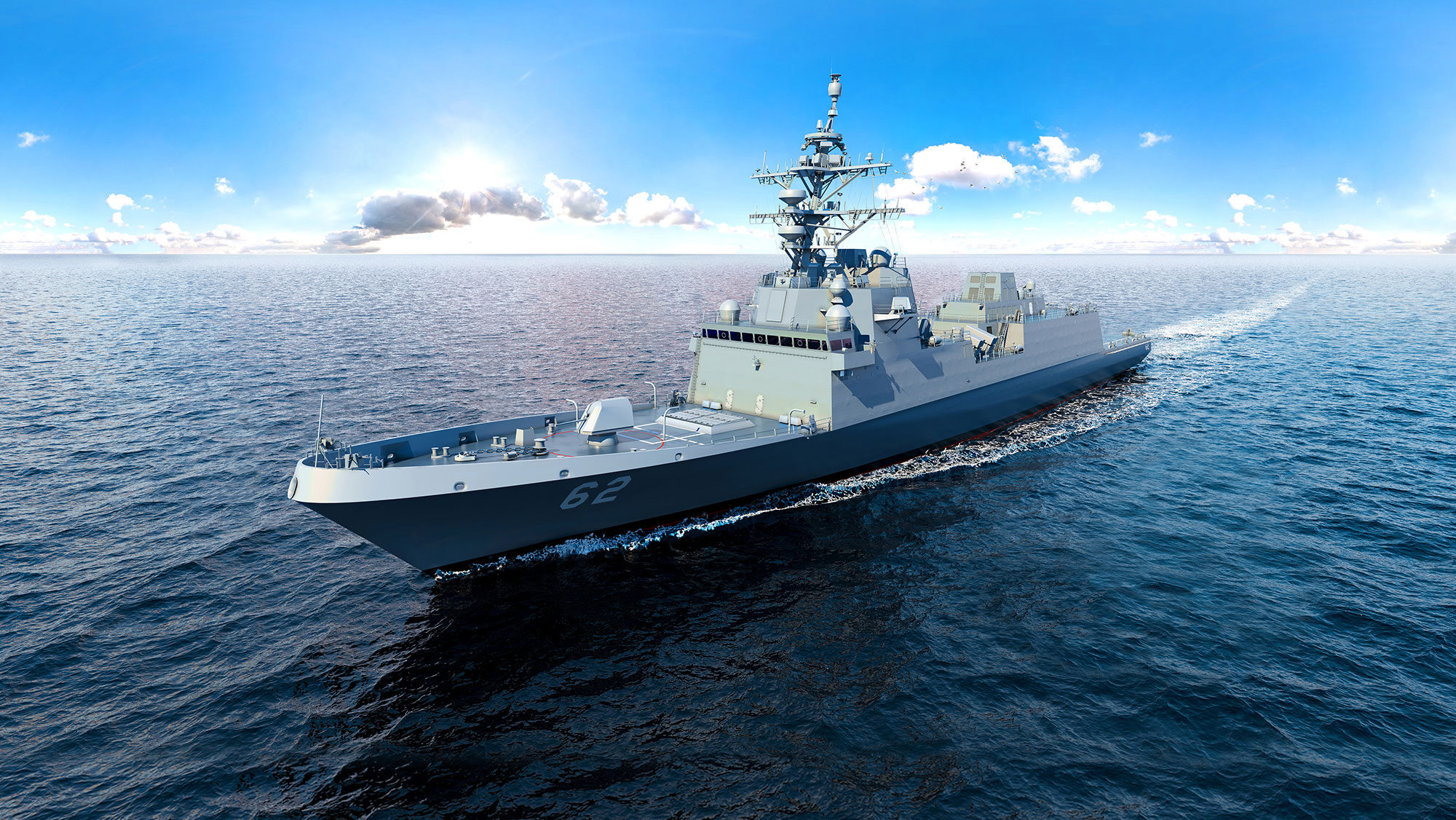

The US proposal is Fincantieri Marinette Marine's Constellation class... so basically we could say it's an italo-american proposal

Almost nothing Italian left in the Constellation class honestly.
FMM only owns part of the design - the design agent is Gibbs & Cox and the Combat System agent is Lockheed Martin. The Italians handed over their design drawings and since then have had no role in Americanizing it. The sensors, weapons, propulsion system, build standards, bow & mast structures are all American. Just about the only thing remaining from the original FREMM is the towed sonar, which is French, not Italian, and the gas turbines, which were already American!
But Fincantieri presumably stand to make a small amount of money both via FMM participating in any export build and via licensing fees (assuming they added an export clause into the USN contract).
IIRC the bits around the GT are added in Italy for French & Italian FREMMs, but I expect the USN insisted on changing them, as well.
TBH, I don't know why they bothered to use a foreign design, since they've redesigned the whole thing.
The Constellation class is proposed to Norway by Fincantieri-Vard, not by Gibbs &Cox.
VARD Group is 100% controlled by Fincantieri.
Fincantieri Marinette Marine (or the entire Fincantieri Marine Group if you prefer) is also controlled totally by Fincantieri.
So, I really dont understand when you say Italy (but it could be Malaysia for what I care) has "almost nothing" to do with the Constellation class.
It's not the italian or french version of FREMM, but it's still a Fincantieri proposal.
And, if it is selected, the builder ( VARD) is 100% owned by Fincantieri, too.
H_K
What I mean is that the US government requires « Chinese walls » for foreign suppliers and designs. So FMM is staffed by Americans, with US security clearances and Fincantieri Italy can’t access any design documents at FMM, let alone share them with Norway. Also since FMM are just a yard and not a designer or systems integrator, and they couldn’t use Fincantieri’s Italian design team, they had to subcontract design work to Gibbs & Cox who took the Italian design plans and changed 85% of the ship, and they had to subcontract systems integration to Lockheed Martin.
So at this point FFG-62 is a US design, by US designers, in a US yard, with US weapons and systems, which will require US Navy approval and involvement for any foreign sale. There are no Italians involved and it will be Americans at Fincantieri US handling any export sales, with Americans at Gibbs & Cox and LM continuing to provide design, engineering and integration services to Vard (or any other foreign yard approved by the US gov).
