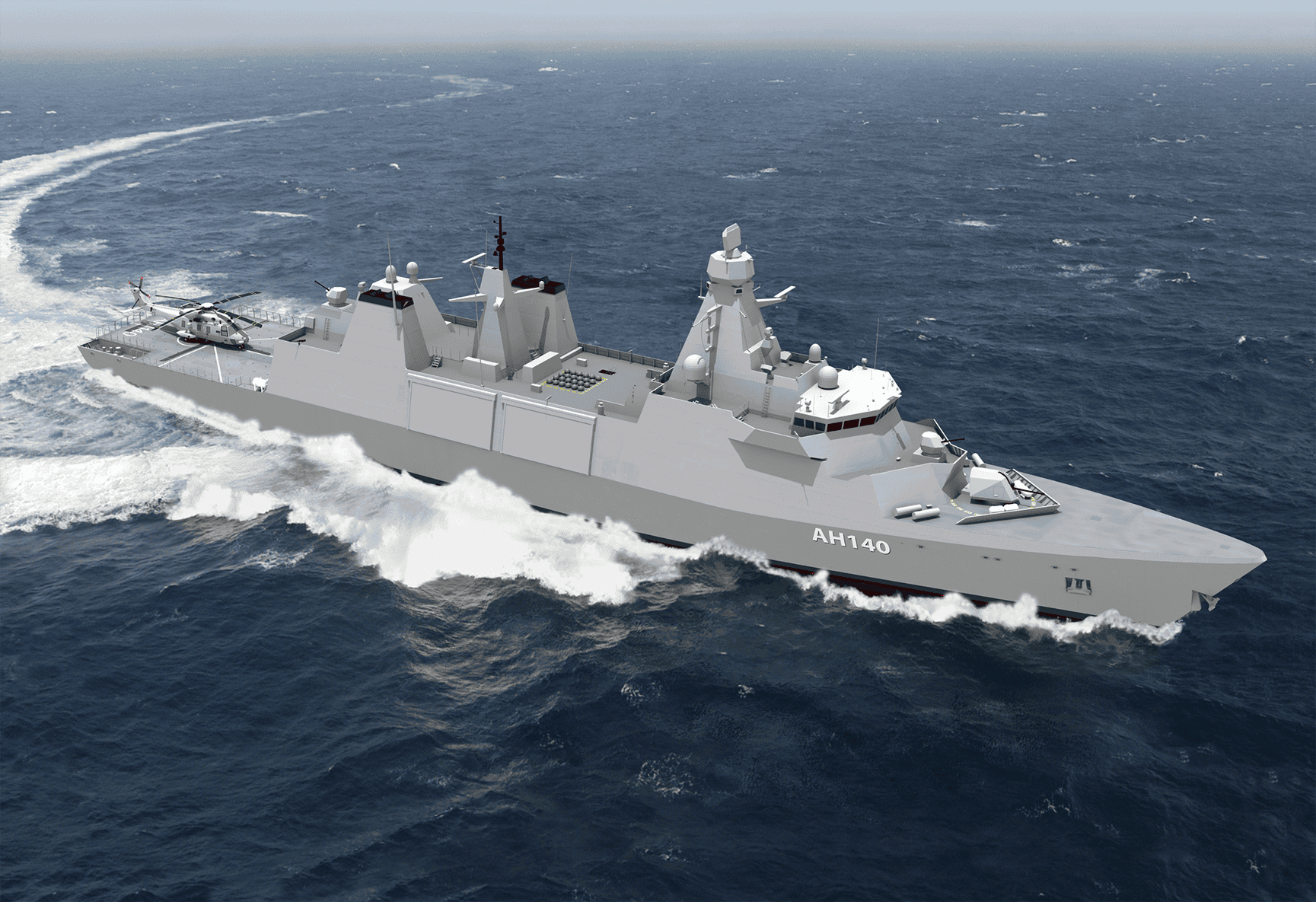

A140
L 138.7m
B 20.4m
D 5.5m
SD 5,700 tons
FLD 7,700 tons
R 9,000nm at 15 knts
S 27-29 knts
C 100-120, 150-180 accomodation
VLS 32 cells
Meriv90
On the A140 it doesnt say 9000 at 15knts.
It says from 6500 to 9000 depending cruise speed from 12 to 16knts
SO for the sake of your comparison is something between 6500 and probably 7000, 9000 at 15 is an error of 30% quite significant.
Depends on which article you read, the iver huitfeld class says 9,300nm at 18knts, sea state 0.
From the designer

A140
L 138.7m
B 20.4m
D 5.5m
SD 5,700 tons
FLD 7,700 tons
S 27-29 knts
VLS 32 cells
