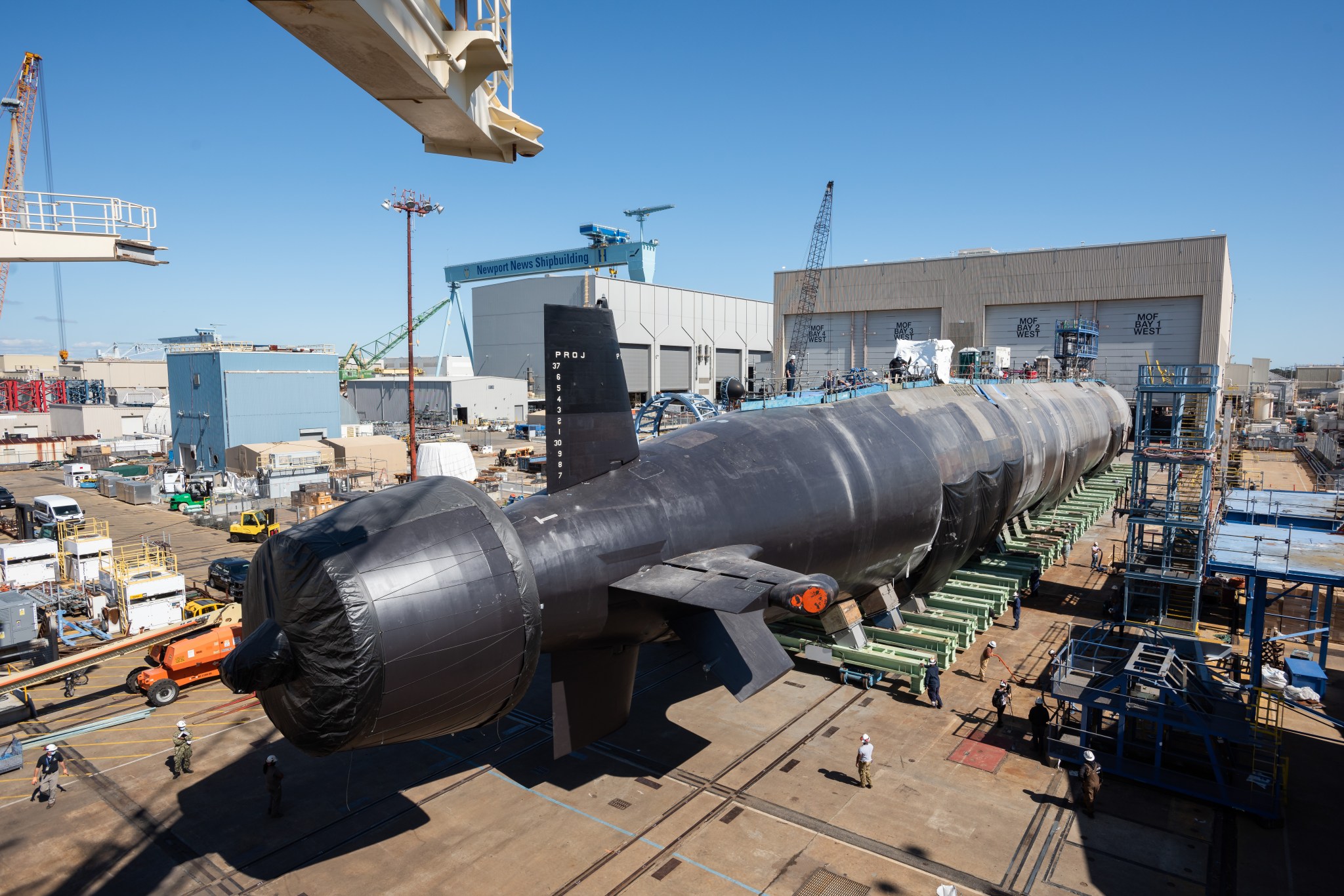

I've held the strong personal view that Virginia Class is the only real option for Australia for quite some time so I have read the discussions here with interest; I could go into a lot of detail on how I formed this position but we are so close to an announcement now that it's somewhat pointless.
I don't think this has been linked here before, I think the timing is interesting, 1 of 3 new US submarine facilities to be built in the coming years;
Also this one from HII;
Lastly, this confirms that the AUKUS announcement will be in Washington DC the US of A.
@NewOzMember
Sorry you do not get away with it that easily. Folk are a tad fed up with claims of a strong reason to support their judgement …. Without the detail.
I have no issue with you indicating that you, personally, prefer the Virginia…. But if you claim to have a strong argument to support that it is the ‘only option’ then provide it. I would suggest that you consider issues such as sovereignty when you make your points.
@NewOzMember
I have a different view on the desirability of Virginias vs Astutes for the RAN. But regardless of the capability of each SSN, I have been concerned that the debate about which SSN is best has completly ignored other more important factors: cost, constructability and operability for the RAN.
On all three of these factors, IMO Virginias come second. They are more costly, more difficult to build in ASC, and more difficult to operate in the RAN owing to larger crew requirements and longer USN training regime.
The articles you linked above are increases in US SSN construction capability previously announced and needed for USN SSN construction to reach the required rate to meet planned fleet numbers. There is no advice that they would provide spare capacity to enable SSN construction for the RAN. To date it has been well below the planned rate (1.2 SSNs per year vs 2 SSNs per year) never mind the desired rate (3 SSNs per year). So IMO there is still little prospect of US built Vieginias for the RAN. Then the question is - can we build Virginias in ASC?
Yet the Virginia is a poor option to build at ASC for multiple reasons:
- US technology export rules (ITAR) still not repealed
- very few of the firms in the Virginia supply chain are in Australia
- on current prices the Virginia would be almost 1/3 more expensive per sub.
So I am not suggesting the Virginias is not a capable SSN. My concern is we cannot realistically get them. So far two US Admirals and two Senators have said the same.[/QUOTE]
