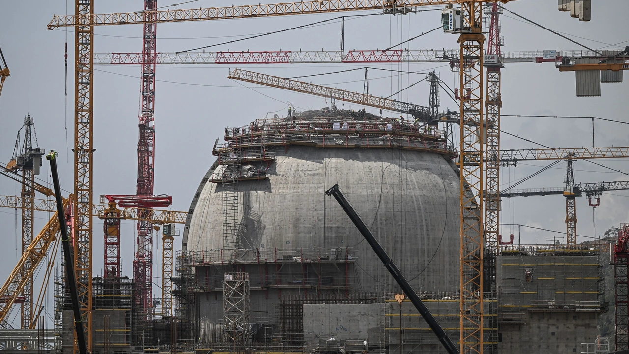

Today Turkiye starts up its first nuclear power plant. It is built by Rosatom and the program started in 2010. The Akkuyu-powerplant in the southern city of Mersin will deliver 10% of Turkish requirements in 2025, and Turkiye hopes with this nuclear powerplant they will be less dependent from other countries.
