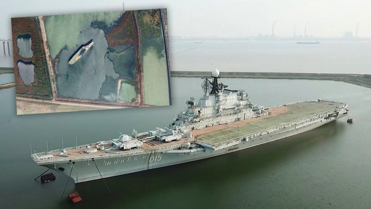

Maybe throw the minsk on a trailer, lick of paint? New kitchen and bathroom? Nz has plenty of experience with reno's
