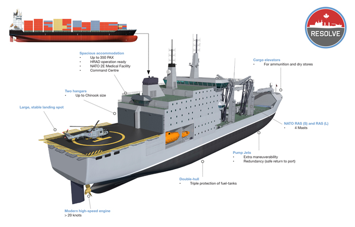

I came across this debate about RO-RO ships being turned into naval Maritime Support Vessel’s on another site and was thinking would this be suitable for NZ as an eventual replacement for Canterbury?, albeit using more modified design using a Point Class RO-RO as its basis. I have had a bit of a search but have not seen any recent information on it. Now I have not seen any visuals on how MSC are changing the MV Gragside. But I was wondering if this idea was feasible in a RNZN context.
https://medium.com/war-is-boring/th...operations-mothership-12801da6f353#.xqg64sn78
If we were to increase the freeboard to the height of the cover bow section, that would enclose the container deck. Increase the height of the bridge area to make a hanger below, forward of the bridge area should be in theory enough for 4 helicopter spots for NH-90 and rated for Chinook. Utilising the aft section behind the bridge/hanger structure with a heave compensated crane it could in theory become a mounting location for 2x LCU MK10. The stern would have to be modified to accept a stern gate marriage between it and the LCU and we need a starboard ramp for vehicle loading. Being 62m longer and 3m wider should in theory give NZN a greater capability overall and with greater capacity to move heavier or larger groups ashore.
I realise I am adding a substantial amount of weight and it may need a plug to increase its length, but looking at the Canadian conversion of MV Asterix to AOR seems to be adding considerable weight as well, I’m not a naval architect
http://3.bp.blogspot.com/-dv0sbyZUcdA/ViWhSI3dKpI/AAAAAAAALSQ/2_9QZK3avbc/s1600/Resolve-SM2.jpg

A purposely designed vessel would be a better option than converting a container ship or a RO-RO. We already have done the RO-RO option with the MRV Canterbury which, whilst it has introduced a new capability, also has limitations that restrict its operation.
