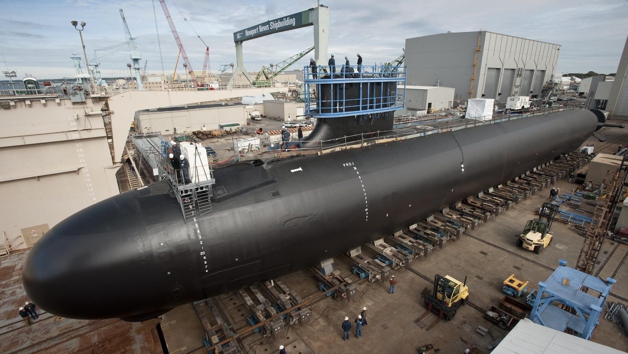

two articles today in Breaking Defense with updates on AUKUS Virginia sub plans including the initial delivery time frames and initial planning on building a Nuclear industry. I’m not clear what they will actually do prior once trained to getting any subs.
Sub three will be a new Build Virginia Block VII in 2038 with no VPM. There is mountain to climb both in the US yards and supply chain and in building an Australian industry capable of supporting the subs before any of this comes to fruition.
New build Virginias will put pressure on the AUKUS SSN program to deliver. Part of me thinks that life would be much easier if we just went with a proven off the shelf design such as the Virginia.
