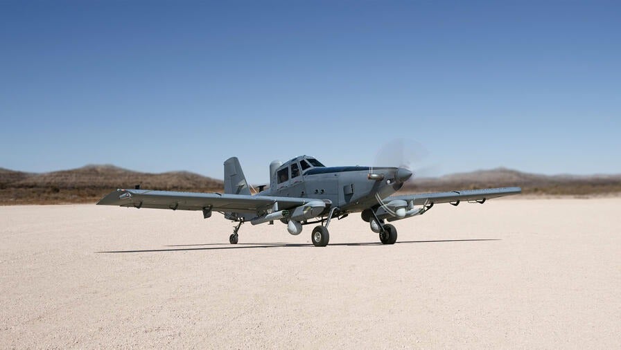

The US Air Force is now deploying the OA-1K light attack derivative of the turboprop-powered AT-802 crop duster aircraft, finally plugging the COIN gap left vacant by the retirement of the OV-10 Bronco by the Air Force and Marines in the 1990s.
