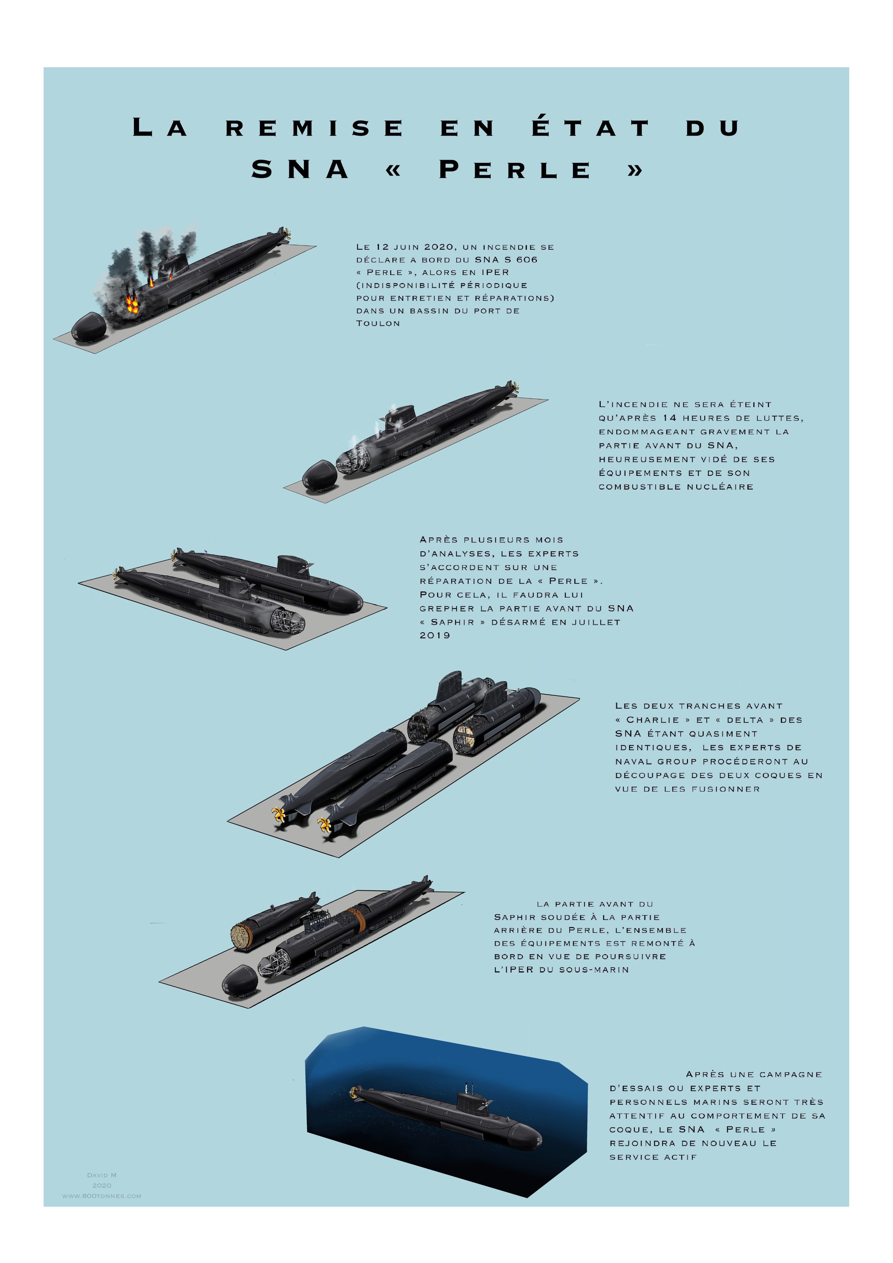

Well it seems that scrapping the Perle won't be happening. Defense News is reporting that the undamaged aft section of the Perle will be removed and welded to the forward section of the decommissioned Saphir. The cost is reported to be around €120 million. The defense ministry would pay €70 million, and €50 million would be covered by a Naval Group insurance payment.

Does beg the question though why not just recommission Saphir? As second of the Rubis class (but first to be decommissioned) was there an issue with the propulsion system (including the reactor) which makes marrying the undamaged propulsion from Perle with the forward section of Saphir simpler/cheaper.
A nifty graphic on the FS Perle rebuild
I found a much larger/readable version of the graphic (link below) unfortunately I don't speak/read French and am way to lazy at the moment to try and translate it online...lol
Saphir's 9 years older, & I think 9 years is quite a long time in the life of a submarine's propulsion system. It could be easier & cheaper to cut them in half & fit Saphir's bow to Perle's rear than to bring Saphir's propulsion up to the standard of Perle's.

Saphir entered the dismantling process in July 2019 at Cherbourg and was first denuclearized, which by publicized timeframe for the process presumably finished around early 2020.
Denuclearization means that they cut out the entire hull section with the reactor, then welded the remaining sections forward and aft together and put the submarine back in the water to be moored somewhere for later disassembly - which would be the current state of Saphir. The reactor section would be disfunctional and in long-term storage at Homet.
In other words, while the other hull sections can be re-used or cannibalized, Saphir ain't sailing anywhere under her own power.
It is also the simple explanation for why and how they came up with this particular solution that fast: There is an existing, up-to-date current process with Naval Group for cutting up submarines at hull section edges and for reassembling them - and conveniently Saphir as the "process prototype" for this specific submarine design just underwent this process only half a year before the fire and is sitting unused at some quay in Cherbourg as a potential donor.
Something that I'm still try to find out. Saphir is the second boat and before Amethyst upgrade program. While Pearle is the last boat in the class. I know both Rubis and Saphir already being upgrade to Amethyst standard, however does the electronics and sensors of Saphir will match with all Pearle system.
Or it doesn't matter since this upgrade will take care this matter anyway.
