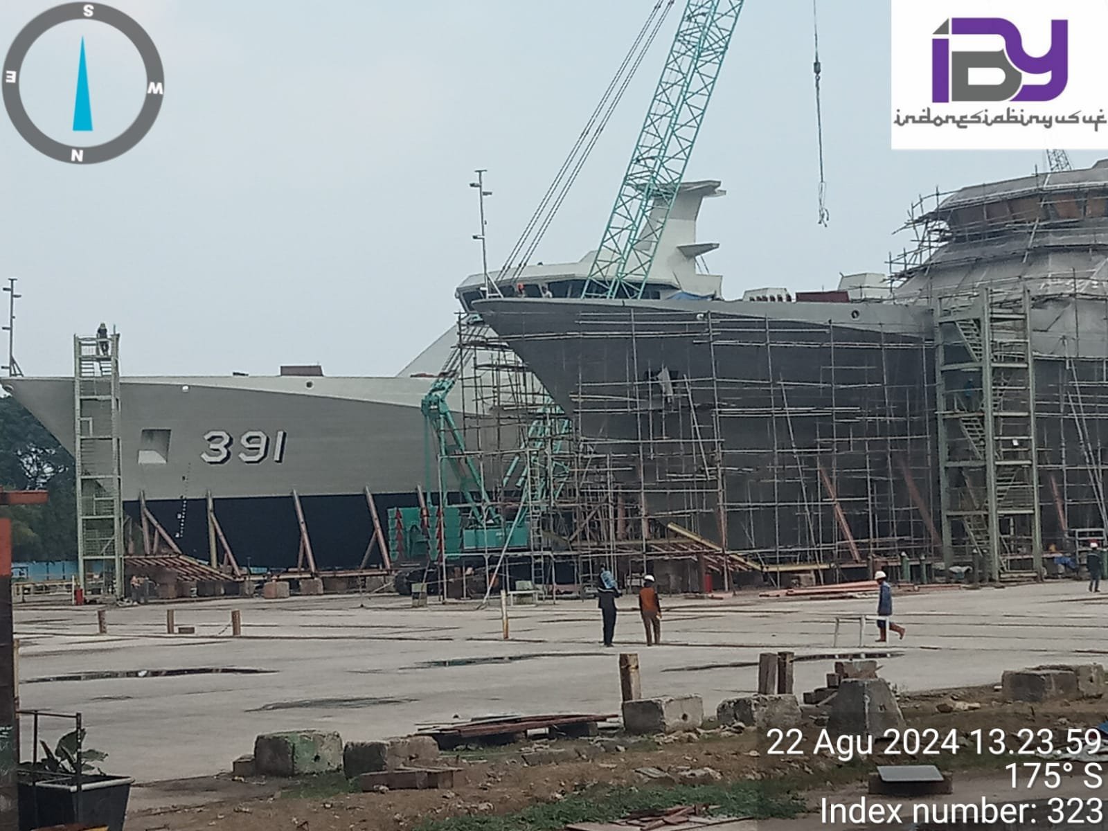

OPV-90 at PT DRU bearing the pennant 391
GV0CoALa8AAGFrX
Keris FB put more photos on OPV 90 (which actually 98m), including stern door for Rhibs. If all armaments and SEWACO being put as planned, then it's practically more Corvette then OPV. This two will be trials in my opinion on the design. If work, then I suspect they can be work out as replacement for ex East German light Corvette Parchim.
The design can be build and replicate in other local shipyard, just like KCR 40 and 60 which now also being use as PC 40 and 60. The design can also be use as Coast Guard Cutter. This potentially will be economically suitable to get large patrol vessels in suitable quantities.
At last some updates and decent images of DRU's OPV-90 program. Thank you for sharing Koxinga and Ananda!
The pennant number also indicates that TNI-AL regards this class as corvettes, and not as simple patrol boats.
For many years a replacement is required for the Parchim Class corvettes, hopefully the OPV-90 is satisfying enough for the navy.

8 exocets, a 76mm gun and millenium gun, it's certainly not an OPV.
Yes, it's more and more shown as OPV in name only. Perhaps the OPV'ness of this design more on keeping RHIB bays in steern. It's more likely meet Corvette specs.
