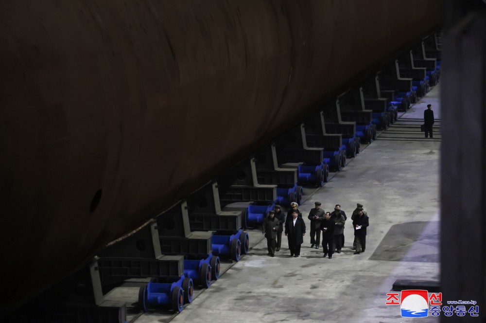

New photos emerge of KJN visiting the construction of the new North Korean "nuclear" submarine.
While the earlier "Hero Kim Gun-ok" submarine was likely to be a modification of an existing Romeo boat, this looks more like a new build, but still based on the original Romeo design, but probably enhanced. Vent holes are different.
As for the very telling elongated mast for the SLBMs (10?), i think we are seeing this because of the diameter/beam of the hull. It is narrow (?~7 meters). We have good proxies of how a diesel SSB should look like without that odd sail; their arch-enemy South Korea and the KSSIII Batch 2, with a 9.6 meter beam.
The Missile located in sail. It could be 2 row 5x2 launcher or 5 single row launcher. I suspect the later as Kim want to put large missile there that able to reach US West Coast.
This the development that push (according to Kim) DPRK to develop Nuclear Power Submarine. The actual more likely the other way around.
None of the SLBMs can reach the West Coast if fired from the Sea of Japan.
It is strictly a regional deterrence.
If they manage to get their Pukguksong 6 operational as intended, then potentially it can get 12000 Km or 8000 miles.
The best current candidate for deployment on the SSBN is the largest SLBM thus far revealed by North Korea, presumably designated the Pukguksong-6. It was first paraded in April 2022 but not yet flight-tested. Based on its size (about 13 meters long and 2.2 meters in diameter), this missile, in theory, could be capable of a range of upwards of about 12,000 km (comparable to the similar-size 1990 US Trident-II/D5 SLBM)—enough to strike all of the continental US from waters close to North Korea. (The North probably would use a taller “turtleback” missile section to accommodate a 13-meters-long missile and its ejection and launch gear in a sub with an 11.5-12.5 meter- diameter hull.)
It is the SLBM that speculate being intended for this SSBN. In which looking the speculation size on parade pictures, seems the Submarine could only put 5 of them in single row behind the sail. We don't know if their intended SLBM can reach that range. However if they could, then they can reach US Western Coast.

Thanks. Sutton speculated on a "large" submarine (H I Sutton - Covert Shores), but I am unsure if this is the same one.
If they indeed design for Pukguksong 6 (~13 m) and this is that boat, the sail is indeed unusual, because the beam should have been wide enough to support a milder "hump". We have US Ohio and UK Vanguard class as reference as they both field Trident D5 (13.5 metre) and they do not have a massive sail.
If that sail is not free flooding, they are going to have an interesting stability situation when diving or surfacing!
