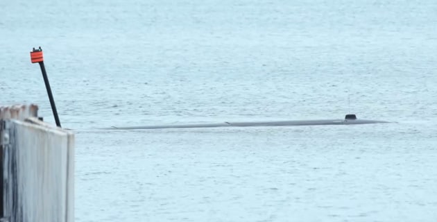

One question are the trailer mounted/or container systems able to be swapped/replenished at sea ? these are different of course to reloading VLS tubes. Speartooth might be deployable from the Hunter class multi purpose bays it would be interesting to know the type of payload being considered for this
