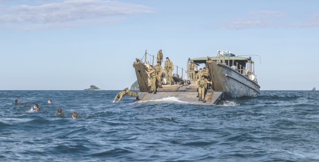

Army v RAN politics may come into it, remember the Balikpapan Class LCH were originally Army but the RAN ended up taking them of the Army's hands. Crewing a larger vessel may be an issue for the Army, get up into the 45-50m range then you are going from a Crew of 3-5 to 6-10 and probably going from a Corporal to a Sergeant in command.
From memory the LCH was originally to have been commanded by a WO2.
What was more interesting was the LSMs, operated by the Army that the LCHs replaced, and even more interesting, the LSM MK2, designed to replace the LSM, but cancelled in favour of the LCH. These were all planned as army vessels, able to transport a troop of tanks and other assorted vehicles, plus personnel, stores etc.
Is there anything an LCM type can do that an LCH type couldn't do better?
Is there anything an LCM type that can't fit in an LHD or LPD can do that an LCU that can fit in a large amphib can't?
Steel is cheap and air is free so why acquire a vessel that doesn't offer much over a type that would fit in an amphib. If it's going to be too big to fit in a Canberra, why not make it as big as it can be, but can still access the restricted litoral waters required?
I think this is some what my concern with this project
I get Army have a long history with the LCM8.
In reality it is a connector converted to have some limited ability to conduct independent operations
We made do with what we had.
The LCM1e is good for what it is intended to do, but will need further "tweeking" or replacing as Armys equipment gets heavier.
The LCM8 is an oppertunity.
If a large LCH is too big and an LCM too small, then if something is needed in the middle ground I'd still suggest it should have the ability to still fit and deploy within the LHD's.
Call it a LCU or whatever, but probably it would have the same width as the LLC of 6.4 m and some added extra length.
The LHD's could fit two of such units with spare space for other smaller water craft yet to be acquired.
A 30m LCU will be able to carry all of ARMYs vehicles and still have the ability to self deploy, which is what it will be used for the majority of time.
Then it comes down to how important is it for the Army to be able to move 70t M-1 Abrams from the LHD to shore but look at the possible compromises you will need to make.
1/ Possibly an ILS with inferior seakeeping and endurance
2/ You now have an inferior capability to move just about every other Vehicle in the Army from ship to shore due to the fact that you have gone from 4 LCMs to 2 slightly larger LCMs
You are deciding which LCM to get on just one requirement while ignoring all the others.
Also the ADF is looking at a LCH replacement and a 1500t+ LST is going to be a far better way to put MBTs across a beach then a LCM. Could carry an entire Troop, support Vehicles, Logistics etc.
To clarify
LHD still has four connectors that hopefully can still transport the heaviest of vehicles. Currently LCM1e
LCU for independent coastal operations to replace the LCM8 - LHD compatible.
LCH replacement about 70% bigger than the Balikpapan Class.
Something that can independently sail to Norfolk / Cocos / Christmas island and return.
More along the lines of an enhanced US Runnymede Class.
Purchase in decent numbers rather than getting fewer much larger vessels that become problematic with beaching and extracting.

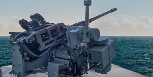

Small article in ADM - EOS has released a maritime variant of it’s R400 remote weapon station and such will be supplied as GFE for LAND
8710-1 Littoral Manoeuvre Vessel – Medium capability. Probably mounting 12.7mm guns I would expect, though M230LF 30mm guns remain an outside possibility down the track, depending on how important Army sees a counter-UAS capability in it’s weapon systems…
