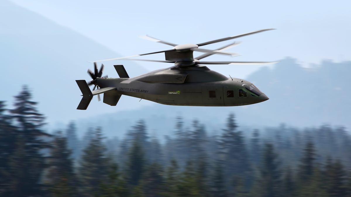

The Army has issued a RFP to Lockheed Martin and Bell for the FLRAA. The Lockheed Martin contender is the Sikorsky Boeing SB-1 Defiant which is a coaxial main rotor helicopter with a pusher propeller mounted at the end of the tail boom. The Bell contender is the Bell V-280 Valor which is a conventional tiltrotor. At the same time the FARA project appears to be progressing in parallel. It is thought that the same aircraft will participate in the competition. It is not known when the RFP for that will be issued.

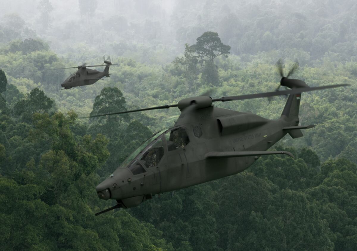

The RFP for FARA was issued years ago, bids were down selected to the LockMart/Sikorsky Raider X and Bell 360 Invictus over a year ago. With the competitive fly-off scheduled to commence toward the end of next year

First was the age of the system. The RAH66 was already long over due enough that it’s systems were obsolete. Second was the mission wants. They had dramatically changed. The Army wants a faster bird. The cruise speed of Invictus is projected at 180kn. That’s faster than the max speed dash of RAH66. Also Stealth isn’t as much a factor. RAH66 wanted to be stealth. But the Army reassessment realized that at helicopter altitude, the bigger threats were in visual range and able to hear the chopper. At that range radar would see it anyway. Then you look at what was being pushed at it. They intended to make it replace Apache too. A set of external stores was being developed. That would have rendered what stealth it had pointless. On top of it all it was eating a huge hole in Army Aviation.
Cool idea questionable practicality. Aspects of it like fly by wire, IR suppression, vibration control are probably in both I even suspect the sun is strongly derivative of Comanche’s. But in mission doctrine FARA and RAH66 are night and day. The Army drafted this more for scout and urban knife fights than the Stealth scout cavalry of Comanche.
Invictus resemblance to Comanche was due to low drag, Bell finally dropped the festron tail likely saving on weight perhaps getting them closer to projected top speed. Though I still favor Raider X. Faster more potential for mission growth.

The Future Vertical Lift program to procure both a future long-range assault aircraft (FLRAA) and a future attack reconnaissance aircraft (FARA) at nearly the same time.
IMO, the US Army can dream but it must execute within cost margins. For FARA, Bell revealed its 360 Invictus (First flight planned in 2023) and Sikorsky revealed its Raider X. Of the 5 competitors, only two were down selected by the US Army to build prototypes — in Apr 2021, Lockheed Martin company Sikorsky’s S-97 Raider helicopter prototype has flown two demonstrations for the US Army. Maj. Gen. Wally Rugen, who is in charge of the US Army’s FVL modernization and oversees the FARA and FLRAA programs, told Defense News in a recent interview that he believes the program can live within the means laid out in the report.
“Our assessments are that we are below that 1.6 percent and that 4.6 percent,” Rugen said. “We have to live with that, below our means, and our program has to stay there to maintain affordability.”
