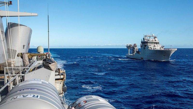

I didn't know whether to put this one on the RNZN thread or the RAN thread. Defence Connect showing there very high standard of research again, the butt of one of the Air Warfare Destroyers and another vessel that certainly does not belong to the ADF
You would have thought they could have managed a better photo of an RAN vessel.
ADF arrives in Hawaii ahead of RIMPAC
How to wind sailors up? Do a sail past the local flesh pots and pubs knowing that none of those onboard can go ashore to sample the delights of said flesh pots and pubs. It's a cruel and unusual punishment.
Nighthawk.NZ
HMA Ships Hobart and Stuart conducted Officer of the Watch Manoeuvres with HMNZS Manawanui from the Royal New Zealand Navy off the coast of Oahu, Hawaii before sailing to take part in RIMPAC 2020.
Credit: Australian Department of Defence/LSIS Christopher Szumlanski.
Still better looking then the Kiwi Ship, gawd that thing is uglyo_O
