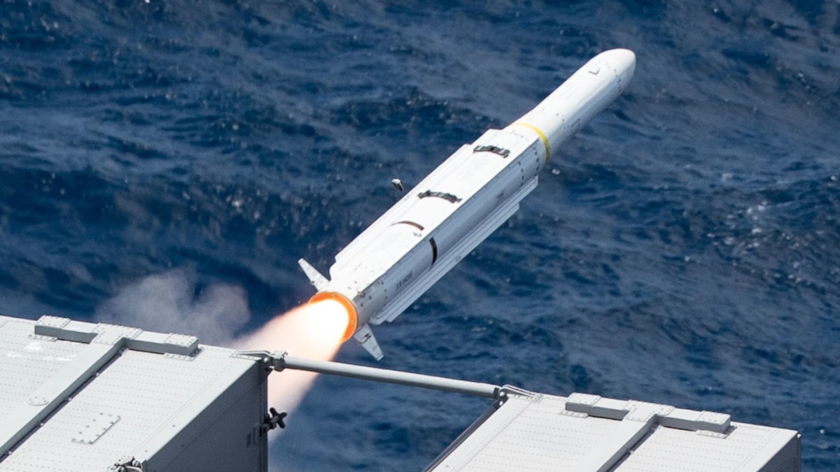

Can the RAN’s stocks of ESSM Block 1 be upgraded to Block 2 level?
Define upgrade. Pretty much the only part that is the same is the rocket body, at least in size. The cheapest part. IF we are going to all the trouble of doing that, the we might as well make more rocket motors, and double our total inventory. As I understand it, the rocket motor is one of the parts we can produce locally.
I presume that Blk I will be in the national stockpile. If we run low, then we can carry a mix of blk I and Blk II. Nothing really wrong with Blk I. It does its job, if you are depleting your magazine, and threats are getting close then blk 1 is still very capable for that. Given the commonality, it would be worth keeping blk I operational. The advantages of Blk II are particularly for long range engagements.
If there is a missile we need loads of its ESSM. Our ships can carry loads of them today. Plus NASAMs.. We will need lots for tomorrow. In a shooting war, or even enforcing a no drone/air zone they are likely to be consumed pretty quickly. Even if we aren't at war, one of our allies may need some, and having a large war stock, they will gladly take ESSM BlkIs, reloading from Australian ports. Being a solid rocket motor, it is a missile you could, with volume and scale, produce cheaply and in volume.
