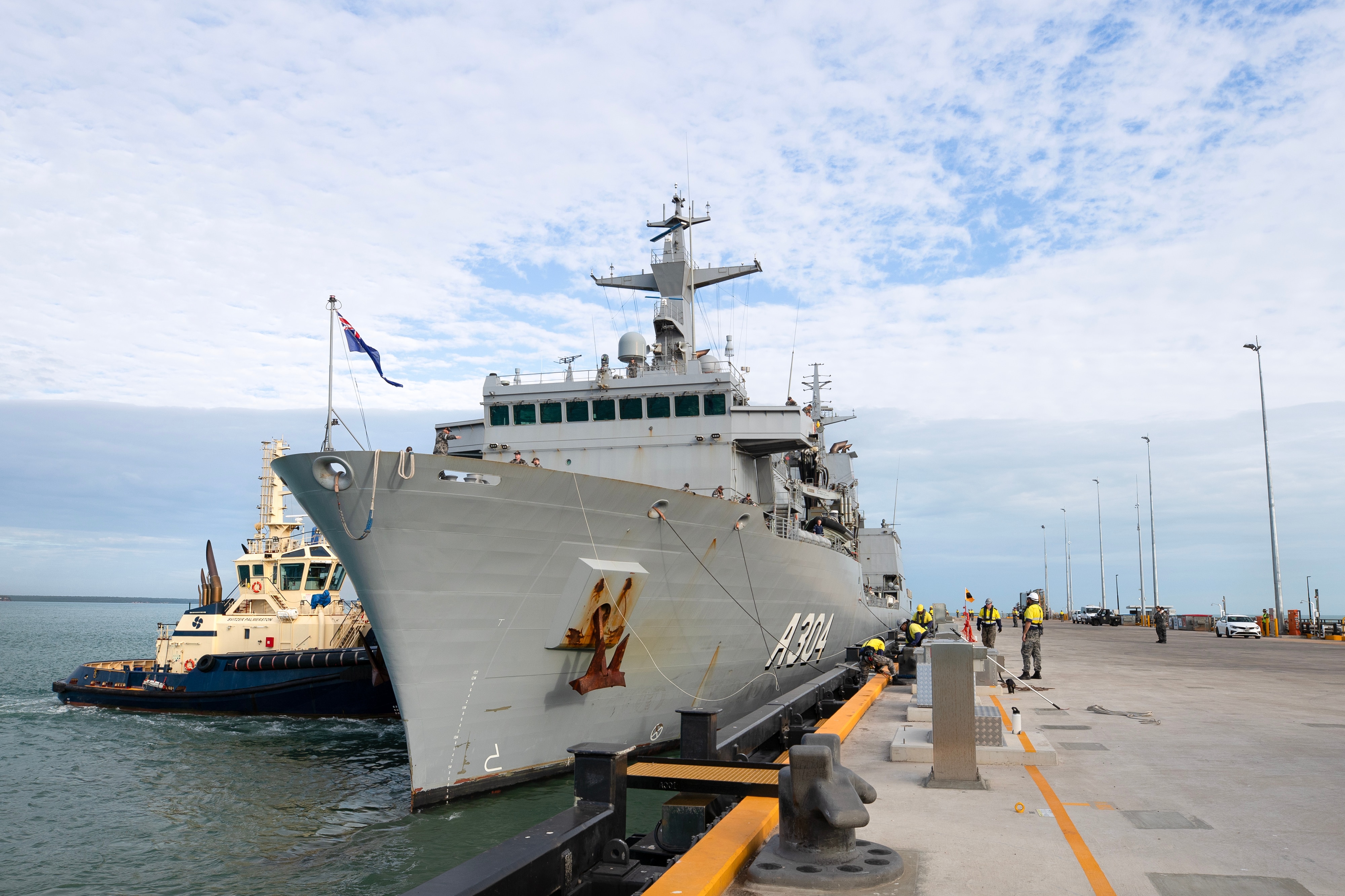

HMAS Stalwart is stuck in Darwin broken down with “engine defects”. This means both of our newish Spanish built auxiliary ships are out of service. That can’t be good. Is there a problem with this design pr its construction?
Is this why some here speak warily of Navantia as a supplier?
Reptilia
Hopefully not the same issue as supply.
They might need 2 replacements from elsewhere. 1 was expected to come soon to fill in for HMAS Supply.
There is an AOR expected soon to fill in for Supply? Got any more information on that, first I've heard of it.
Wonder how busy the Kiwi's are keeping HMNZ Aeoteroa at present, might have to see if they are up for a 6 month or so lease of ship and crew.
A most disappointing outcome
One would have thought the Supply class would of being a straight forward project
We had an established relationship with the supplier in Navantia with the Hobart and Canberra Classes
Plus we had access in home waters to the parent designed Cantabria which should of been a solid test of what we were about to buy.
... and yet we keep going back for more ships. The definition of insanity is when you keep doing the same thing over and over again and expect different results.
