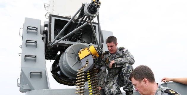

See the Phalanx has been fitted, above the Hangar. Must have happened during the final fit out in WA.Some of my shots of NUSHIP Supply pulling into FBE for the first time this morning. Shot from Bradley's Head. Nice morning chatting to 2 IS sailors who were taking some video and stills. Good to see all the weapon systems already fitted.
View attachment 47931View attachment 47932
Yes good to see that Phalanx has been fitted.See the Phalanx has been fitted, above the Hangar. Must have happened during the final fit out in WA.
Yep and twin Typhoon systems (covered) either side of the funnel.See the Phalanx has been fitted, above the Hangar. Must have happened during the final fit out in WA.
Could be that we simply don’t have a Phalanx to mount in the forward position yet? We only have (off the top of my head) 16 or so Phalanx systems in-service, some are fitted to the AWD’s, and some of them are un-available, being away in the upgrade process being readied for Block 1B2 standard...Yes good to see that Phalanx has been fitted.
It was interesting when the ships were first announced that graphics released by the RAN showed two Phalanx fitted, one on the hangar and one forward of the bridge, which didn’t happen in reality.
But I do note that from all of the images I’ve seen of NUSHIP Supply show that there is a mount forward of the bridge for future potential use of a second system.

Or occy strap a Hawkie with Amraam somewhere up front and stick another with radar on-top the bridge. The 2020 equivalent of bolting RBS70 to Success.Could be that we simply don’t have a Phalanx to mount in the forward position yet? We only have (off the top of my head) 16 or so Phalanx systems in-service, some are fitted to the AWD’s, and some of them are un-available, being away in the upgrade process being readied for Block 1B2 standard...
If only one was available, I suppose protecting the rear hemisphere of the ship with a bigger field of fire, must be the preferred position?
Personally I’d prefer to see a 21 round, RIM-116 RAM Block II launcher up front anyway, but maybe that’s just me... Obviously RAN doesn’t agree...![]()
Or the NASAMS ii static launcher at least, anyway...Or occy strap a Hawkie with Amraam somewhere up front and stick another with radar on-top the bridge. The 2020 equivalent of bolting RBS70 to Success.
You may be right. There certainly appears to be the mounting bed plate on the focsle. Given time we may see two fitted.Could be that we simply don’t have a Phalanx to mount in the forward position yet? We only have (off the top of my head) 16 or so Phalanx systems in-service, some are fitted to the AWD’s, and some of them are un-available, being away in the upgrade process being readied for Block 1B2 standard...
There was an announcement back about 2017 on the Phalanx systems the RAN currently owns and if I remember correctly they said 12 and laid out a plan for fitting them, 1 each for the Hobarts, 1 each for the Choules and the 2 new AORs, leaving 6 for the Canberra’s to be fitted in 2019, Canberra is currently in Refit so may emerge with 1 or more fitted.Could be that we simply don’t have a Phalanx to mount in the forward position yet? We only have (off the top of my head) 16 or so Phalanx systems in-service, some are fitted to the AWD’s, and some of them are un-available, being away in the upgrade process being readied for Block 1B2 standard...
Agree, I don’t think there enough Phalanx to go around the entire fleet.Could be that we simply don’t have a Phalanx to mount in the forward position yet? We only have (off the top of my head) 16 or so Phalanx systems in-service, some are fitted to the AWD’s, and some of them are un-available, being away in the upgrade process being readied for Block 1B2 standard...
Its 12 John as per the link provided by @StingrayOZ above and going on that article only 6 have been delivered back to Australia. You would think that the weapon systems for at least the first 3 Hunters will have to be ordered in the next couple of years, some interesting choices to be made there on the CIWS and possibly the SSM. The 3 on the Hobarts have to be changed over and sent back for upgrading.Agree, I don’t think there enough Phalanx to go around the entire fleet.

Yes and no.Its 12 John as per the link provided by @StingrayOZ above and going on that article only 6 have been delivered back to Australia. You would think that the weapon systems for at least the first 3 Hunters will have to be ordered in the next couple of years, some interesting choices to be made there on the CIWS and possibly the SSM. The 3 on the Hobarts have to be changed over and sent back for upgrading.
www.australiandefence.com.au
Makes sense on an AOR though.Not a big fan of the size and location of the pennant number, just doesn’t look right on an RAN ship.
