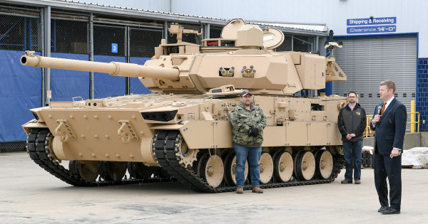

What about the US Griffin 2 (MPF program)? Can we expect something there? Or just a normal light-medium tank?
Terran
MPF is dedicated to the light tank class. This is why one of the two known contenders is the old M8 resurrected.
It’s a 105mm tank gun mated with current fire control. The aim is an air drop tank for airborne.
Air-droppable or air-transportable? Also, doesn't it feature a modular armor scheme that can cause its weight to fluctuate considerably? Even with the heavier armor packages it still doesn't approach a medium tank?
@Feanor, I don’t know the answer to most of your questions but I think it is safe to say that I do not expect a build contract for a true next generation MBT to be awarded in the next 15 years — the replacement of the Leclerc and Leopard-2 tanks is scheduled in 2035. I also don’t think facial recognition tech is that important to the battle net.

I stand corrected air deploy not drop but early on they said drop.The original 1980s was supposed to be air drop but never realized that goal.
this slide from 2018 even says drop. 9AD6A4DA-B7E5-4324-B13B-0CD3C100C67D.jpeg
The term light tank is consistent with the program. The M8 has an aluminum hull and is the basis of BAEs
