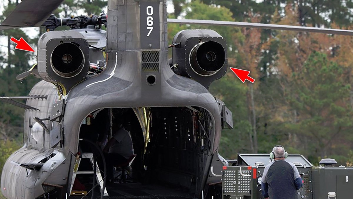

Wouldn’t say zero growth, an engine upgrade may happen which should enhance its capability. Bottom line, a reasonably priced and proven platform with a small growth potential versus an unproven extremely expensive platform albeit with some significant advantages. Basically the same con job Sikorsky used to fool the Liberal government of the day with the Cyclones (not that it took much effort to fool Canadian Liberals).:p

wouldn’t say zero. Although more mature Chinook has a lot of potential.
As is Chinook generally is the fast Chopper in the world. Updated with more powerful engines it could be faster, has the best hot and High performance of any type, it’s tandem configuration gives it advantages not found in other choppers. It’s a design that I am amazed isn’t more common for heavy lift class. Many a year ago it looked like Boeing and Airbus Eurocopter were willing to partner for a Super Chinook to meet just this requirement. That was 2008-2010.
Nothing came of it but it shows some of the potential For the design.
Current work has dropped some weight well increasing lift. Concepts have been floated increasing speed more or better lift.
