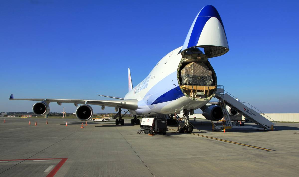

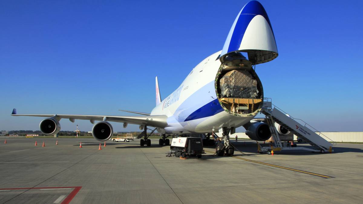

The four engines that still found difficulty to attract market for converting in to Freighters are A-380. 747 has capabilities to be converted to have front cargo door, thus can give access to certain cargo type. Technically A-380 should have more cargo space than 747. However from what I gather it can't provide flexibility of 747. Seems Airbus rumours still working on that.
Didn’t realize passenger 747s could have the option for a front loading door on conversions, thought that was only on 747Fs, another reason A380 conversions would be a tough sell without this.
It's an expensive conversion option, according to this article most of converted 747 owner choose not to take it. However seems the article hinted it's available if some cargo Airliners want to choose it.
According to IAI Bedek, they can provide variety of cargo loading options in their highlight page line. Still their video shown cargo door in rear fuselage, that's seems in line with what simple flying article on 747 conversion above.
