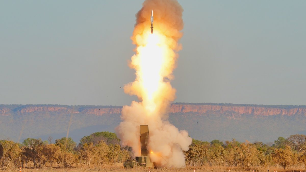

As in the recent Talisman Sabre exercise the Typhon can be air lifted to those countries allied to Australia
While SM-6 has a useful secondary role as an ASM, it is an AAW missile. Sure, it is fast but as a result it’s flight profile is not the ideal one for surface attack - there are better options.
While SM-6 has a useful secondary role as an ASM, it is an AAW missile. Sure, it is fast but as a resultit’s flight profile is not the ideal one for surface attack - there are better options.
The Tomahawk as the article goes into can also be deployed from the Typhon ,the sm-6 does though have a dual role for attack and defence , being air portable provides options
